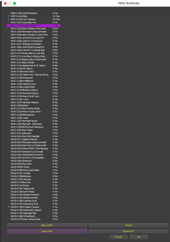

- During the last 15 Years sailing between Scilly Islands and Stockholm + countries/Channel Islands in between, I have collected 2,000+ waypoints.
- In the past used various Applications (InavX, Navionics etc.) and as a rule, NV Charts as hard copy charts.
- QTvlm is my future 3 x app with master installation on MacOS, iPadOS and IOS (iPhone).
Marks Management
- I have an estimated 300 Archive Titles used by NV Charts - see example: eu.nvcharts.com/9953/nv-charts-england-uk3-the-solent/
- Districts Maps and Detailed Maps titles refers.
- I have created a number of Archive Titles for testing (MacOS only).
- Is it possible to create Archives titles on MacOS app/files, then
- Export the data
- Import data to iPadOS and IOS installations, then
- Import Archive header details only
- Individual POI/Marks/Beacons will be imported later using "Import GPX".
- If import is not possible, could I edit using A Text editor of the file containing the Archieve headers?
- Files: poiArchives.dat, poiReal.dat refers
- Only option for each installation apply.

This can be done on one machine and then exported via menu->qtVlm->export qtVlm data, which you can then reimport on another machine or device. You can for instance export/import POIs archives and current POIs, routes, tracks, etc.
I don't understand what you mean by "Headers only"
Regards,

Thank you for clarification. I am following your instruction now, tested export option and all well.
